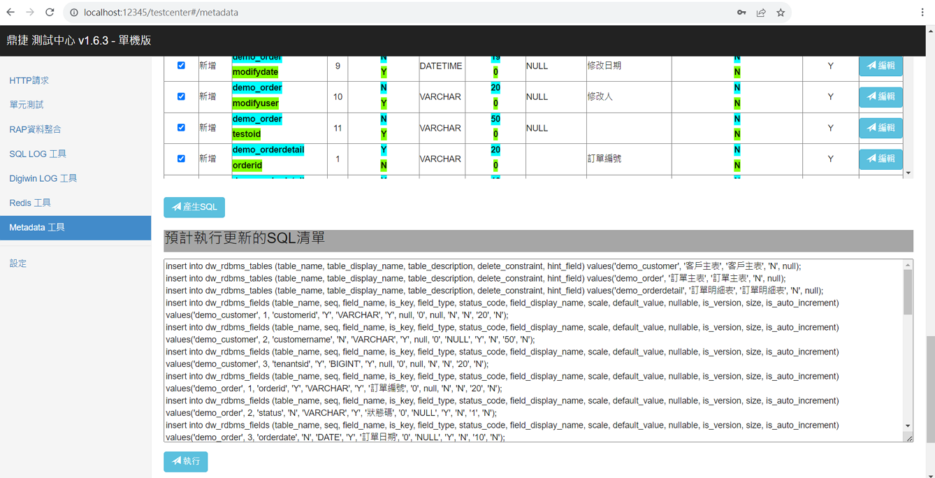

新增数据报错 Can't find this Metadata(ogawa_fsh_acco ...
新增数据报错 Can't find this Metadata(ogawa_fsh_account_set)!"
52
发表于 2024-12-27 23:29:59
"std_data":
"execution":
"sql_code": "",
"code": "-1",
"stacktrace": "java.lang.reflect.InvocationTargetException\r\n\tat sun.reflect.NativeMethodAccessorImpl.invoke0(Native Method)\r\n\tat sun.reflect.NativeMethodAccessorImpl.invoke(NativeMethodAccessorImpl.java:62)\r\n\tat sun.reflect.DelegatingMethodAccessorImpl.invoke(DelegatingMethodAccessorImpl.java:43)\r\n\tat java.lang.reflect.Method.invoke(Method.java:498)\r\n\tat com.digiwin.app.container.ServiceFuse.execute(ServiceFuse.java:17)\r\n\tat com.digiwin.gateway.fuse.execute.DWFuseRunnable.lambda$getReturnConsumer$2(DWFuseRunnable.java:47)\r\n\tat com.digiwin.gateway.fuse.execute.DWFuseRunnable.lambda$getReturnRunnable$0(DWFuseRunnable.java:23)\r\n\tat io.vavr.control.Try.run(Try.java:118)\r\n\tat io.vavr.control.Try.runRunnable(Try.java:134)\r\n\tat com.digiwin.gateway.fuse.DWFuseExecutor.onExecute(DWFuseExecutor.java:55)\r\n\tat com.digiwin.gateway.fuse.DWFuseExecutor.execute(DWFuseExecutor.java:193)\r\n\tat com.digiwin.app.container.DWMethod.invoke(DWMethod.java:228)\r\n\tat com.digiwin.app.container.DWContainerContext.invoke(DWContainerContext.java:231)\r\n\tat com.digiwin.app.container.DWContainerContext.invoke(DWContainerContext.java:186)\r\n\tat com.digiwin.gateway.controller.EaiController.eai(EaiController.java:293)\r\n\tat sun.reflect.NativeMethodAccessorImpl.invoke0(Native Method)\r\n\tat sun.reflect.NativeMethodAccessorImpl.invoke(NativeMethodAccessorImpl.java:62)\r\n\tat sun.reflect.DelegatingMethodAccessorImpl.invoke(DelegatingMethodAccessorImpl.java:43)\r\n\tat java.lang.reflect.Method.invoke(Method.java:498)\r\n\tat org.springframework.web.method.support.InvocableHandlerMethod.doInvoke(InvocableHandlerMethod.java:209)\r\n\tat org.springframework.web.method.support.InvocableHandlerMethod.invokeForRequest(InvocableHandlerMethod.java:136)\r\n\tat org.springframework.web.servlet.mvc.method.annotation.ServletInvocableHandlerMethod.invokeAndHandle(ServletInvocableHandlerMethod.java:102)\r\n\tat org.springframework.web.servlet.mvc.method.annotation.RequestMappingHandlerAdapter.invokeHandlerMethod(RequestMappingHandlerAdapter.java:877)\r\n\tat org.springframework.web.servlet.mvc.method.annotation.RequestMappingHandlerAdapter.handleInternal(RequestMappingHandlerAdapter.java:783)\r\n\tat org.springframework.web.servlet.mvc.method.AbstractHandlerMethodAdapter.handle(AbstractHandlerMethodAdapter.java:87)\r\n\tat org.springframework.web.servlet.DispatcherServlet.doDispatch(DispatcherServlet.java:991)\r\n\tat org.springframework.web.servlet.DispatcherServlet.doService(DispatcherServlet.java:925)\r\n\tat org.springframework.web.servlet.FrameworkServlet.processRequest(FrameworkServlet.java:974)\r\n\tat org.springframework.web.servlet.FrameworkServlet.doPost(FrameworkServlet.java:877)\r\n\tat javax.servlet.http.HttpServlet.service(HttpServlet.java:707)\r\n\tat org.springframework.web.servlet.FrameworkServlet.service(FrameworkServlet.java:851)\r\n\tat javax.servlet.http.HttpServlet.service(HttpServlet.java:790)\r\n\tat org.apache.catalina.core.ApplicationFilterChain.internalDoFilter(ApplicationFilterChain.java:231)\r\n\tat org.apache.catalina.core.ApplicationFilterChain.doFilter(ApplicationFilterChain.java:166)\r\n\tat org.apache.tomcat.websocket.server.WsFilter.doFilter(WsFilter.java:52)\r\n\tat org.apache.catalina.core.ApplicationFilterChain.internalDoFilter(ApplicationFilterChain.java:193)\r\n\tat org.apache.catalina.core.ApplicationFilterChain.doFilter(ApplicationFilterChain.java:166)\r\n\tat org.springframework.boot.actuate.metrics.web.servlet.WebMvcMetricsFilter.filterAndRecordMetrics(WebMvcMetricsFilter.java:158)\r\n\tat org.springframework.boot.actuate.metrics.web.servlet.WebMvcMetricsFilter.filterAndRecordMetrics(WebMvcMetricsFilter.java:126)\r\n\tat org.springframework.boot.actuate.metrics.web.servlet.WebMvcMetricsFilter.doFilterInternal(WebMvcMetricsFilter.java:111)\r\n\tat org.springframework.web.filter.OncePerRequestFilter.doFilter(OncePerRequestFilter.java:107)\r\n\tat org.apache.catalina.core.ApplicationFilterChain.internalDoFilter(ApplicationFilterChain.java:193)\r\n\tat org.apache.catalina.core.ApplicationFilterChain.doFilter(ApplicationFilterChain.java:166)\r\n\tat org.springframework.boot.actuate.web.trace.servlet.HttpTraceFilter.doFilterInternal(HttpTraceFilter.java:84)\r\n\tat org.springframework.web.filter.OncePerRequestFilter.doFilter(OncePerRequestFilter.java:107)\r\n\tat org.apache.catalina.core.ApplicationFilterChain.internalDoFilter(ApplicationFilterChain.java:193)\r\n\tat org.apache.catalina.core.ApplicationFilterChain.doFilter(ApplicationFilterChain.java:166)\r\n\tat com.digiwin.gateway.filter.LogContextFilter.doFilter(LogContextFilter.java:65)\r\n\tat org.apache.catalina.core.ApplicationFilterChain.internalDoFilter(ApplicationFilterChain.java:193)\r\n\tat org.apache.catalina.core.ApplicationFilterChain.doFilter(ApplicationFilterChain.java:166)\r\n\tat com.digiwin.gateway.filter.TokenFilter.doFilter(TokenFilter.java:208)\r\n\tat org.apache.catalina.core.ApplicationFilterChain.internalDoFilter(ApplicationFilterChain.java:193)\r\n\tat org.apache.catalina.core.ApplicationFilterChain.doFilter(ApplicationFilterChain.java:166)\r\n\tat com.digiwin.gateway.filter.TokenAllowAnonymousFilter.doFilter(TokenAllowAnonymousFilter.java:59)\r\n\tat org.apache.catalina.core.ApplicationFilterChain.internalDoFilter(ApplicationFilterChain.java:193)\r\n\tat org.apache.catalina.core.ApplicationFilterChain.doFilter(ApplicationFilterChain.java:166)\r\n\tat com.digiwin.gateway.service.permission.DWSecurityContextInitFilter.doFilter(DWSecurityContextInitFilter.java:80)\r\n\tat org.apache.catalina.core.ApplicationFilterChain.internalDoFilter(ApplicationFilterChain.java:193)\r\n\tat org.apache.catalina.core.ApplicationFilterChain.doFilter(ApplicationFilterChain.java:166)\r\n\tat com.digiwin.gateway.filter.DWEaiServiceMethodLocateFilter.doFilter(DWEaiServiceMethodLocateFilter.java:88)\r\n\tat org.apache.catalina.core.ApplicationFilterChain.internalDoFilter(ApplicationFilterChain.java:193)\r\n\tat org.apache.catalina.core.ApplicationFilterChain.doFilter(ApplicationFilterChain.java:166)\r\n\tat com.digiwin.gateway.filter.EaiHealthCheckFilter.doFilter(EaiHealthCheckFilter.java:53)\r\n\tat org.apache.catalina.core.ApplicationFilterChain.internalDoFilter(ApplicationFilterChain.java:193)\r\n\tat org.apache.catalina.core.ApplicationFilterChain.doFilter(ApplicationFilterChain.java:166)\r\n\tat org.springframework.web.filter.RequestContextFilter.doFilterInternal(RequestContextFilter.java:99)\r\n\tat org.springframework.web.filter.OncePerRequestFilter.doFilter(OncePerRequestFilter.java:107)\r\n\tat org.apache.catalina.core.ApplicationFilterChain.internalDoFilter(ApplicationFilterChain.java:193)\r\n\tat org.apache.catalina.core.ApplicationFilterChain.doFilter(ApplicationFilterChain.java:166)\r\n\tat org.springframework.web.filter.HttpPutFormContentFilter.doFilterInternal(HttpPutFormContentFilter.java:109)\r\n\tat org.springframework.web.filter.OncePerRequestFilter.doFilter(OncePerRequestFilter.java:107)\r\n\tat org.apache.catalina.core.ApplicationFilterChain.internalDoFilter(ApplicationFilterChain.java:193)\r\n\tat org.apache.catalina.core.ApplicationFilterChain.doFilter(ApplicationFilterChain.java:166)\r\n\tat org.springframework.web.filter.HiddenHttpMethodFilter.doFilterInternal(HiddenHttpMethodFilter.java:81)\r\n\tat org.springframework.web.filter.OncePerRequestFilter.doFilter(OncePerRequestFilter.java:107)\r\n\tat org.apache.catalina.core.ApplicationFilterChain.internalDoFilter(ApplicationFilterChain.java:193)\r\n\tat org.apache.catalina.core.ApplicationFilterChain.doFilter(ApplicationFilterChain.java:166)\r\n\tat org.springframework.web.filter.CharacterEncodingFilter.doFilterInternal(CharacterEncodingFilter.java:200)\r\n\tat org.springframework.web.filter.OncePerRequestFilter.doFilter(OncePerRequestFilter.java:107)\r\n\tat org.apache.catalina.core.ApplicationFilterChain.internalDoFilter(ApplicationFilterChain.java:193)\r\n\tat org.apache.catalina.core.ApplicationFilterChain.doFilter(ApplicationFilterChain.java:166)\r\n\tat org.apache.catalina.core.StandardWrapperValve.invoke(StandardWrapperValve.java:198)\r\n\tat org.apache.catalina.core.StandardContextValve.invoke(StandardContextValve.java:96)\r\n\tat org.apache.catalina.authenticator.AuthenticatorBase.invoke(AuthenticatorBase.java:496)\r\n\tat org.apache.catalina.core.StandardHostValve.invoke(StandardHostValve.java:140)\r\n\tat org.apache.catalina.valves.ErrorReportValve.invoke(ErrorReportValve.java:81)\r\n\tat org.apache.catalina.core.StandardEngineValve.invoke(StandardEngineValve.java:87)\r\n\tat org.apache.catalina.connector.CoyoteAdapter.service(CoyoteAdapter.java:342)\r\n\tat org.apache.coyote.http11.Http11Processor.service(Http11Processor.java:803)\r\n\tat org.apache.coyote.AbstractProcessorLight.process(AbstractProcessorLight.java:66)\r\n\tat org.apache.coyote.AbstractProtocol$ConnectionHandler.process(AbstractProtocol.java:790)\r\n\tat org.apache.tomcat.util.net.NioEndpoint$SocketProcessor.doRun(NioEndpoint.java:1459)\r\n\tat org.apache.tomcat.util.net.SocketProcessorBase.run(SocketProcessorBase.java:49)\r\n\tat java.util.concurrent.ThreadPoolExecutor.runWorker(ThreadPoolExecutor.java:1149)\r\n\tat java.util.concurrent.ThreadPoolExecutor$Worker.run(ThreadPoolExecutor.java:624)\r\n\tat org.apache.tomcat.util.threads.TaskThread$WrappingRunnable.run(TaskThread.java:61)\r\n\tat java.lang.Thread.run(Thread.java:748)\r\nCaused by: com.digiwin.app.metadata.exceptions.DWMetadataNotFoundException: Can't find this Metadata(ogawa_fsh_account_set)!\r\n\tat com.digiwin.app.metadata.loader.DWRdbMetadataLoader.load(DWRdbMetadataLoader.java:273)\r\n\tat com.digiwin.app.metadata.loader.DWRdbMetadataLoader.load(DWRdbMetadataLoader.java:26)\r\n\tat com.digiwin.app.metadata.loader.DWMetadataLoaderManager.load(DWMetadataLoaderManager.java:58)\r\n\tat com.digiwin.app.metadata.DWMetadataContainer.get(DWMetadataContainer.java:73)\r\n\tat com.digiwin.app.dao.dialect.DWCommonSQLDialect.parse(DWCommonSQLDialect.java:921)\r\n\tat com.digiwin.app.dao.generic.DWDataSetDaoImpl.execute(DWDataSetDaoImpl.java:484)\r\n\tat com.ogawa.fsh.dao.basic.impl.AccountSetDaoImpl.PostAccountSet(AccountSetDaoImpl.java:76)\r\n\tat com.ogawa.fsh.service.basic.impl.AccountSetServiceImpl.PostAccountSet(AccountSetServiceImpl.java:29)\r\n\t... 97 more\r\n",
"description": "Can't find this Metadata(ogawa_fsh_account_set)!",
"message": "DWMetadataNotFoundException: Can't find this Metadata(ogawa_fsh_account_set)!"
"parameter":
报错信息 Can't find this Metadata(ogawa_fsh_account_set)!表示找不到ogawa_fsh_account_set这张表的元数据, 请使用DAP微服务测试工具中的Metadata工具新增该表的元数据。 若不清楚操作方式,请参考以下赋能课程的内容。 微服务开发 03.微服务测试工具 05.DAO数据库操作组件 若不知道以上课程在哪里观看,可洽询您的开发顾问。 参考图1 ...
微服务开发
03.微服务测试工具
05.DAO数据库操作组件
