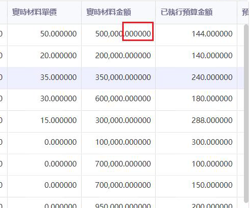

金额组件怎么显示小数位数?
期望显示效果如下图

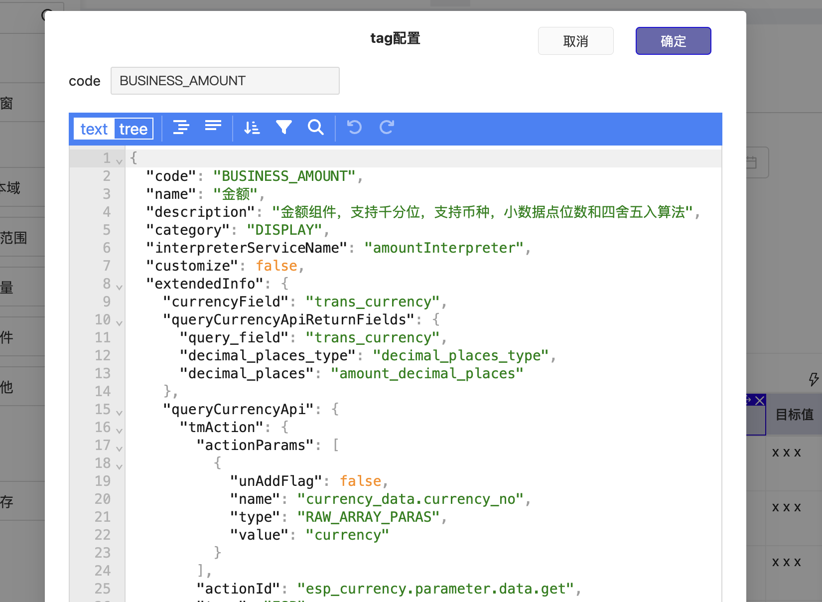

金额组件的小数位数的显示必须配置金额单位,且金额单位必须有数据。
在tag配置中需要加操作,配置queryCurrencyApi和queryCurrencyAPIReturnFields
如下所示:
    "code": "BUSINESS_AMOUNT",
    "name": "金额",
    "description": "金额组件,支持千分位,支持币种,小数据点位数和四舍五入算法",
    "category": "DISPLAY",
    "interpreterServiceName": "amountInterpreter",
    "customize": false,
    "extendedInfo":
        "currencyField": "trans_currency",
        "queryCurrencyApiReturnFields":
            "query_field": "trans_currency",
            "decimal_places_type": "decimal_places_type",
            "decimal_places": "amount_decimal_places"
        "queryCurrencyApi":
            "tmAction":
                "actionParams":
                        "unAddFlag": false,
                        "name": "currency_data.currency_no",
                        "type": "RAW_ARRAY_PARAS",
                        "value": "currency"
                "actionId": "esp_currency.parameter.data.get",
                "type": "ESP"
    "themeMapTag":
        "id": 163511701,
        "name": "采购单价",
        "category": "BUSINESS",
        "uiBotCode": "BUSINESS_AMOUNT"
    "append": false

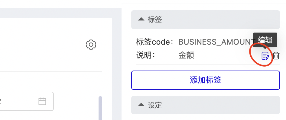

在开发平台添加金额标签,进行tag配置
参考图1&图2
