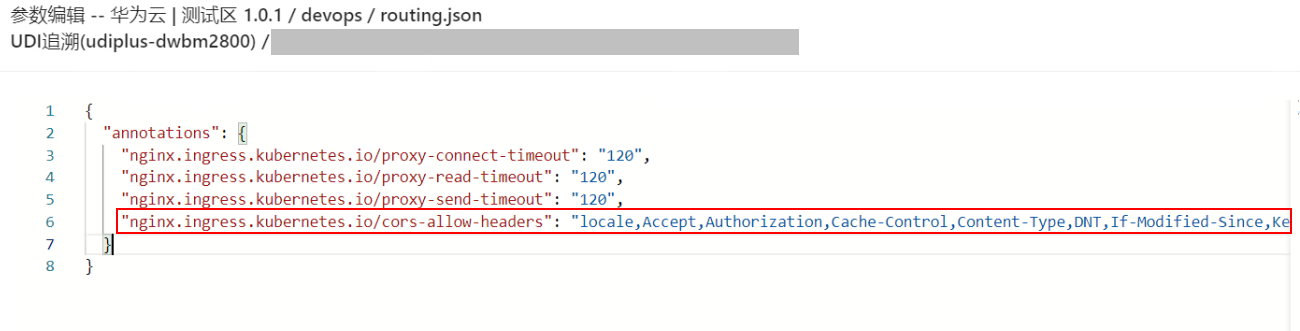

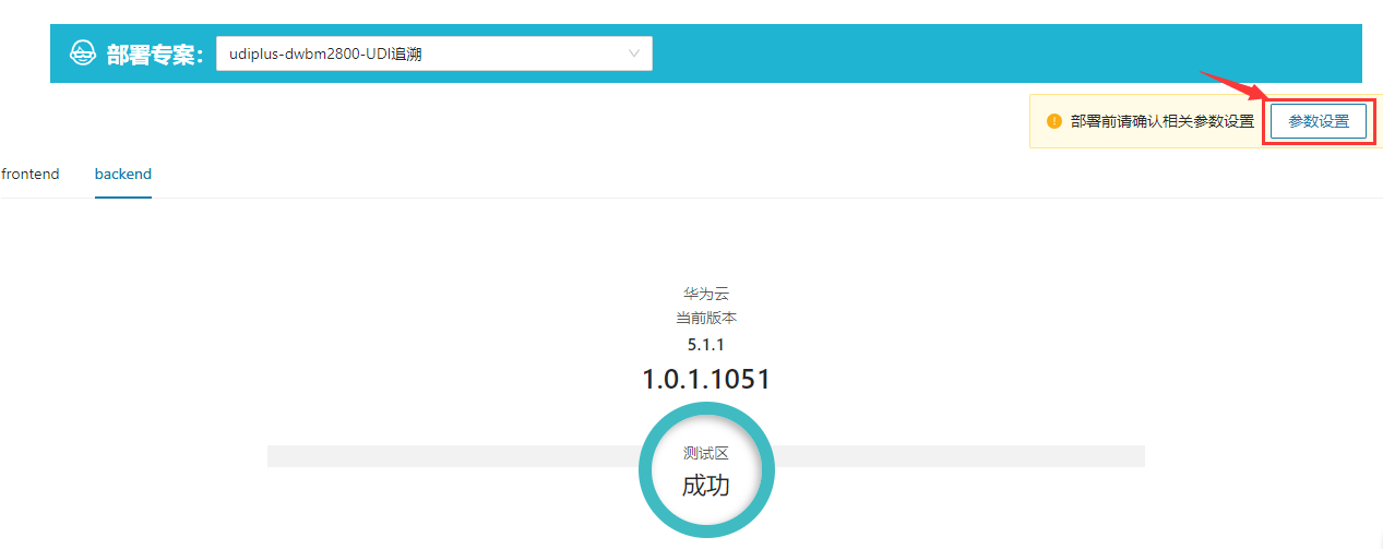

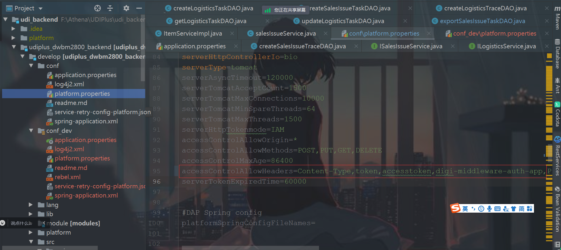

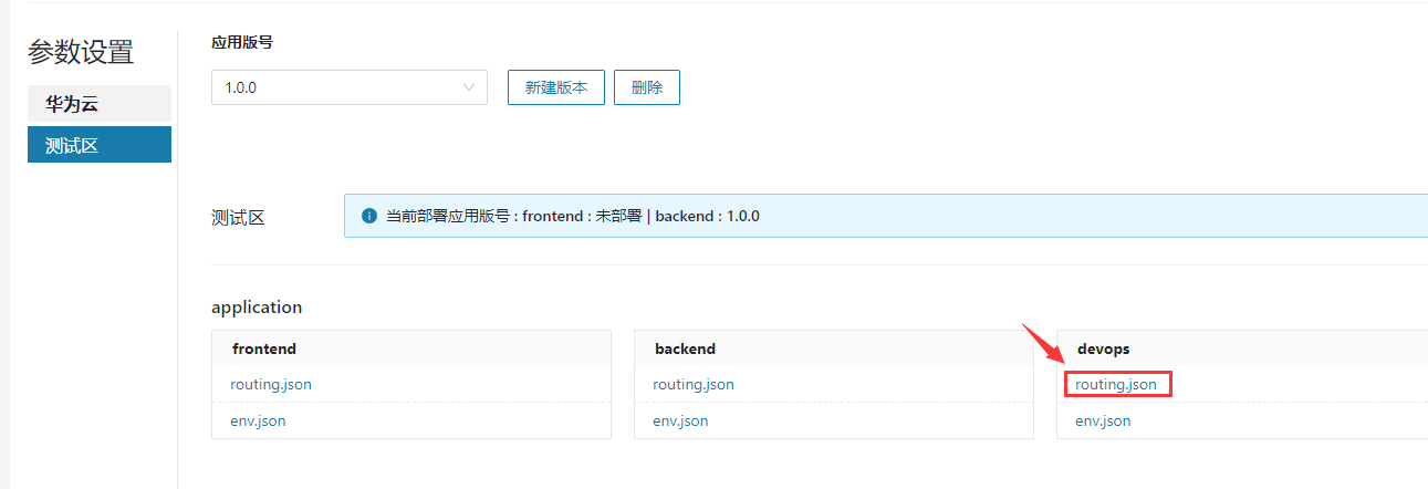

原问题:跨域设定在本地测试正常,部署后无效 原因:部署后,跨域设定,在部署参数中设定 流水线部署 > 参数设置 > devops > routing.json 参考图1&图2&图3 "nginx.ingress.kubernetes.io/cors-allow-headers": "locale,Accept,Authorization,Cache-Control,Content-Type,DNT,If-Modified-Since,Keep-Alive,Origin,User-Agent,X-Mx-ReqToken,X-Requested-With,digi-middleware-auth-app,digi-middleware-auth-access,digi-midd ...
admin楼主Lv.9 发表于 2024-12-27 23:30:37 | 查看全部
参考图1&图2&图3
"nginx.ingress.kubernetes.io/cors-allow-headers": "locale,Accept,Authorization,Cache-Control,Content-Type,DNT,If-Modified-Since,Keep-Alive,Origin,User-Agent,X-Mx-ReqToken,X-Requested-With,digi-middleware-auth-app,digi-middleware-auth-access,digi-middleware-auth-user,digi-middleware-auth-use-info,digi-middleware-drive-access,digi-middleware-drive-access-info,digi-middleware-drive-arg,token,apptoken,client-agent,proxy_token,digi-proxy-token,routerKey,Client-Agent"
