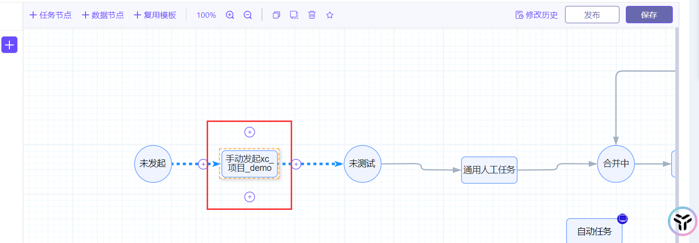

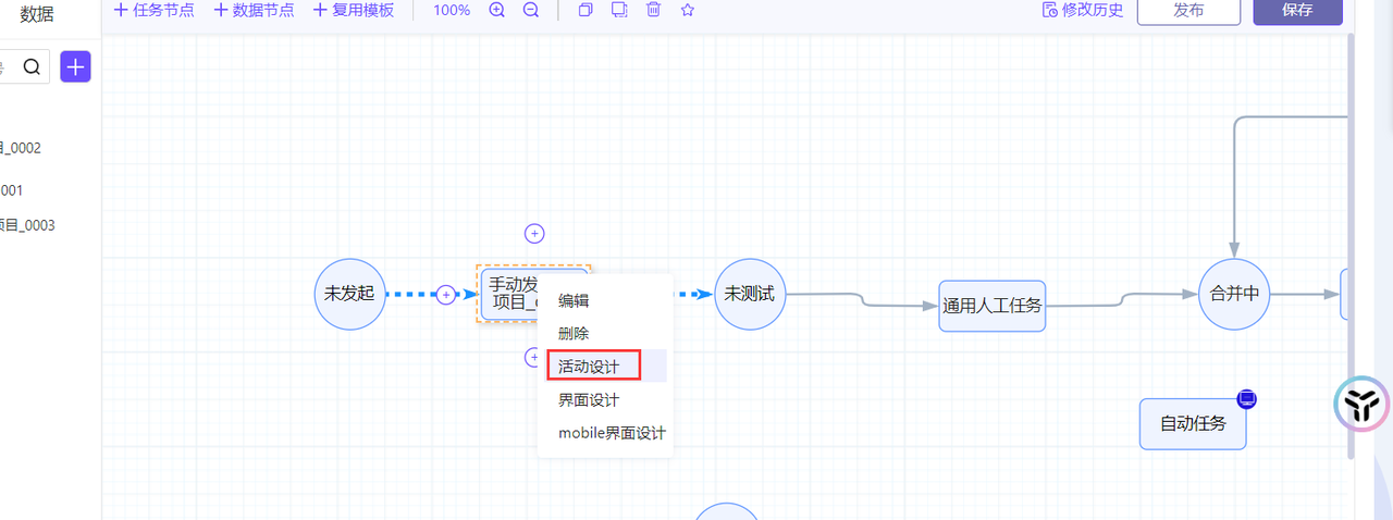

 1、配置内容,点击自动任务,右击打开活动设计

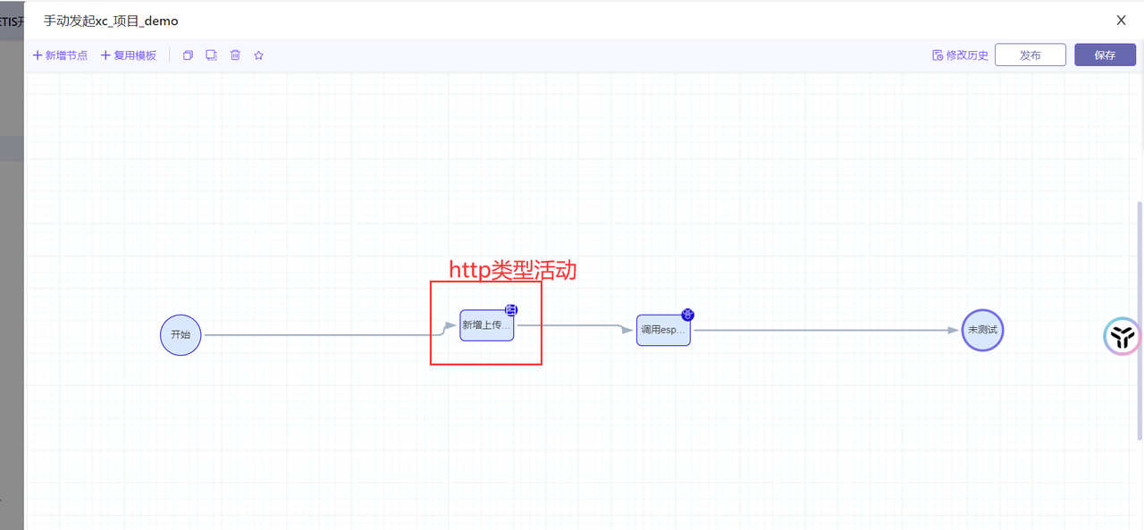

 2、新建一个http的活动节点

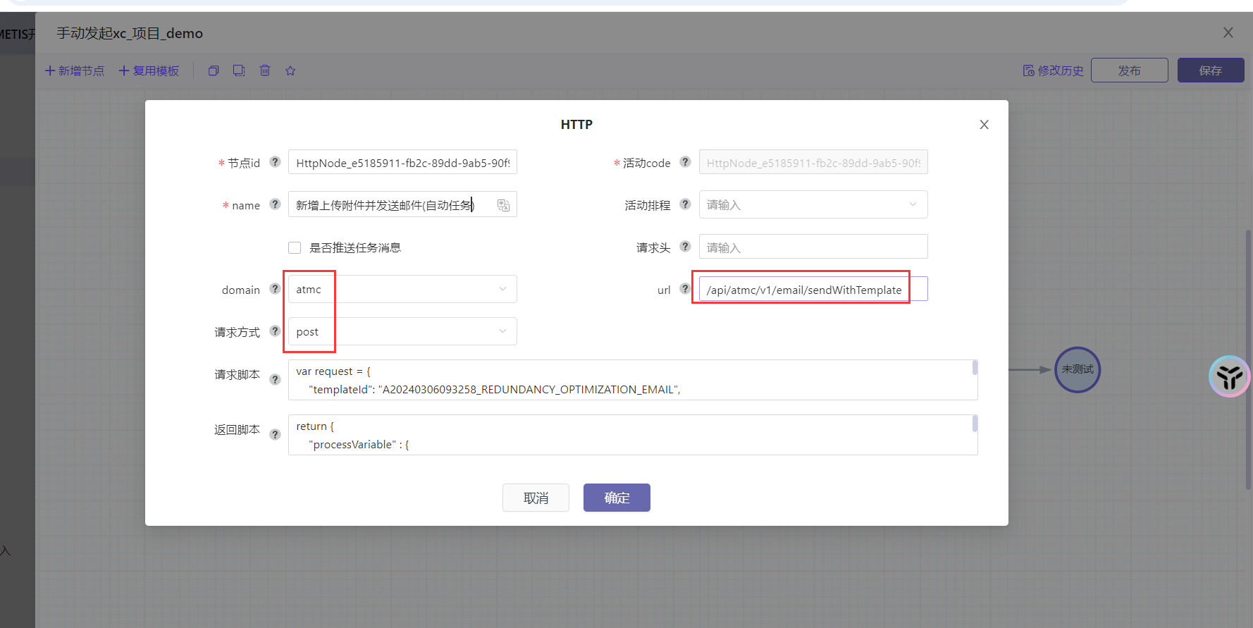

3、配置http活动相关信息,参数如下:
   domain:atmc
   请求方式:post
  url:/api/atmc/v1/email/sendWithTemplate
4、请求脚本demo样例参考:
var request = { "templateId": "A20240306093258_REDUNDANCY_OPTIMIZATION_EMAIL", "contacts": [ "ruangm@digiwin.com", "luodan0120@digiwin.com" ], "attachments": [ { "fileName": "222", "metadata": [ { "field": "age", "sequence": 0, "fieldName": "年龄", "language": { "fieldName": { "zh_TW": "年齡", "en_US": "age", "zh_CN": "年龄" } } }, { "field": "name", "sequence": 0, "fieldName": "姓名", "language": { "fieldName": { "zh_TW": "姓名", "en_US": "name", "zh_CN": "姓名" } } } ], "data": [ { "name": "青青", "age": 18 }, { "name": "金鑫", "age": 18 } ] }, { "fileName": "333", "metadata": [ { "field": "age", "sequence": 0, "fieldName": "年龄", "language": { "fieldName": { "zh_TW": "年齡", "en_US": "age", "zh_CN": "年龄" } } }, { "field": "name", "sequence": 0, "fieldName": "姓名", "language": { "fieldName": { "zh_TW": "姓名", "en_US": "name", "zh_CN": "姓名" } } } ], "data": [ { "name": "青青", "age": 18 }, { "name": "金鑫", "age": 18 } ] }, { "fileName": "444", "metadata": [ { "field": "age", "sequence": 0, "fieldName": "年龄", "language": { "fieldName": { "zh_TW": "年齡", "en_US": "age", "zh_CN": "年龄" } } }, { "field": "name", "sequence": 0, "fieldName": "姓名", "language": { "fieldName": { "zh_TW": "姓名", "en_US": "name", "zh_CN": "姓名" } } } ], "data": [ { "name": "青青", "age": 18 }, { "name": "金鑫", "age": 18 } ] }, { "fileName": "555", "metadata": [ { "field": "age", "sequence": 0, "fieldName": "年龄", "language": { "fieldName": { "zh_TW": "年齡", "en_US": "age", "zh_CN": "年龄" } } }, { "field": "name", "sequence": 0, "fieldName": "姓名", "language": { "fieldName": { "zh_TW": "姓名", "en_US": "name", "zh_CN": "姓名" } } } ], "data": [ { "name": "青青", "age": 18 }, { "name": "金鑫", "age": 18 } ] }, { "fileName": "666", "metadata": [ { "field": "age", "sequence": 0, "fieldName": "年龄", "language": { "fieldName": { "zh_TW": "年齡", "en_US": "age", "zh_CN": "年龄" } } }, { "field": "name", "sequence": 0, "fieldName": "姓名", "language": { "fieldName": { "zh_TW": "姓名", "en_US": "name", "zh_CN": "姓名" } } } ], "data": [ { "name": "青青", "age": 18 }, { "name": "金鑫", "age": 18 } ] } ], "data": { "linkUrl": "https://athena-test.digiwincloud.com.cn/
task/detail/484323878814336?targetTenantId=AthenaWF&shareCode=VYb7pKofp6Nt7oX?engineType=TaskEngine", "title": "", "content": "属于整机生产计划项目的制定整机生产计划-计划名称:dytest0613任务(完成时间为09/20)
已被终止。请点击详情登录Athena进行查看及处理。" } }; return request;

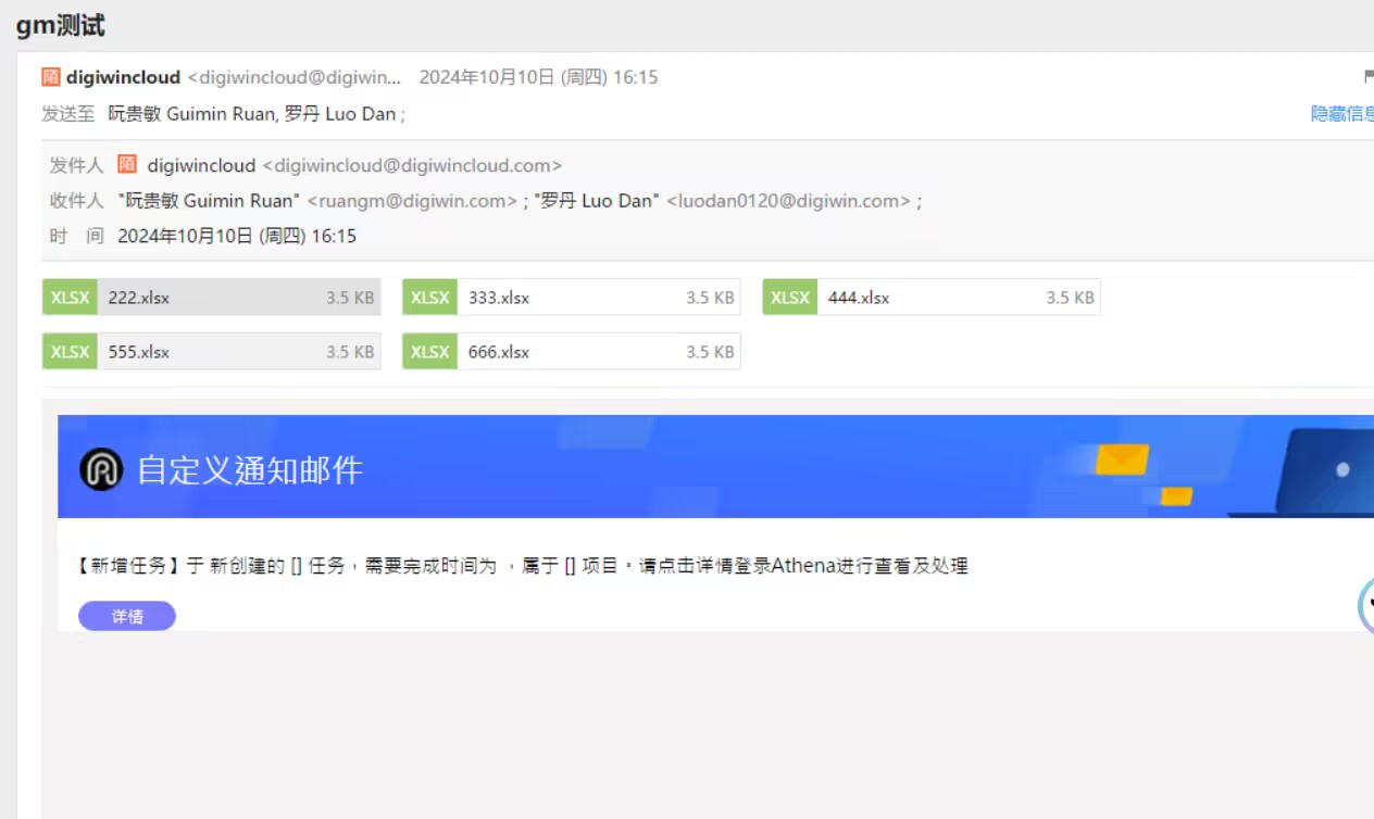

最终实现效果图
