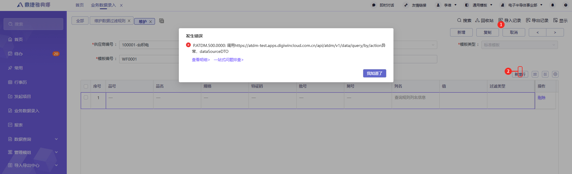

过滤类型栏位新增了自定义校验,运行出现异常: P.ATDM.500.0000: 调用https://atdm-test.apps.digiwincl ... ata/query/by/action异常,dataSourceDTO

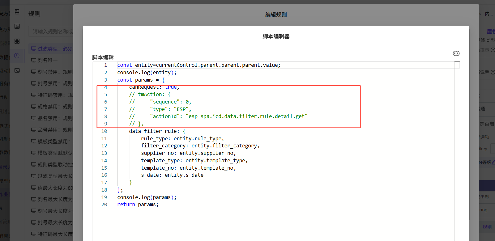

  29.         "en_US": "过滤类型:必须保持一致"
  30.       }
  31.     },
  32.     "linkageSchemas": [],
  33.     "crossFieldOrNot": false,
  34.     "trigger": {
  35.       "type": "async",
  36.       "point": "default",
  37.       "condition": "(() => { const uuid = currentControl.parent.get('uuid').value; const filterType = currentControl.value; const rowValue = currentControl.parent.parent.value;  const result = rowValue.some(item => item.uuid !== uuid && item.filter_type !== '' && item.filter_type !== filterType); return currentControl.value !== '' && result})();",
  38.       "parameterScript": "const entity=currentControl.parent.parent.parent.value;\r\nconsole.log(entity); \r\nconst params = {\r\n    canRequest: true,\r\n    // tmAction: {\r\n    //     "sequence": 0,\r\n    //     "type": "ESP",\r\n    //     "actionId": "esp_spa.icd.data.filter.rule.detail.get"\r\n    // },\r\n    data_filter_rule: {\r\n        rule_type: entity.rule_type,\r\n        filter_category: entity.filter_category,\r\n        supplier_no: entity.supplier_no,\r\n        template_type: entity.template_type,\r\n        template_no: entity.template_no,\r\n        s_date: entity.s_date\r\n    }\r\n};\r\nconsole.log(params); \r\nreturn params;",

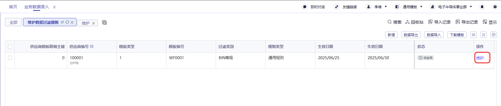

重现步骤:
登陆Athena,进入“业务数据录入”,进入“维护数据过滤规则”浏览界面,选择第一笔数据“维护”。
进入编辑界面,点击“编辑”按钮。明细表表头点击“新增换行”。即可重现问题。
看你的规则中的脚本里面,具体调用接口的代码被注释了,而且传参的格式也不正确 异步请求接口时,脚本中具体配置参考下列代码: let canRequest = false; if (rowData.owner_emp_no) {     canRequest = true } const params = {     canRequest: canRequest,     businessUnit: businessUnit,     tmAction: {         sequence: 0,    &nb ...
翁俊Lv.7 发表于 2025-6-26 11:58:41 | 查看全部
    canRequest = true
const params = {
    tmAction: {
        sequence: 0,
        type: 'ESP',
        actionId: 'esp_dtdapp.outsourced.employees.basic.data.detail.get'   //这里写入你需要调用的接口名称
    paras: {
        outsourced_employees_basic_data: {
            owner_emp_no: rowData.owner_emp_no
        }   //  这里接入你接口的入参key和value值
return params;
