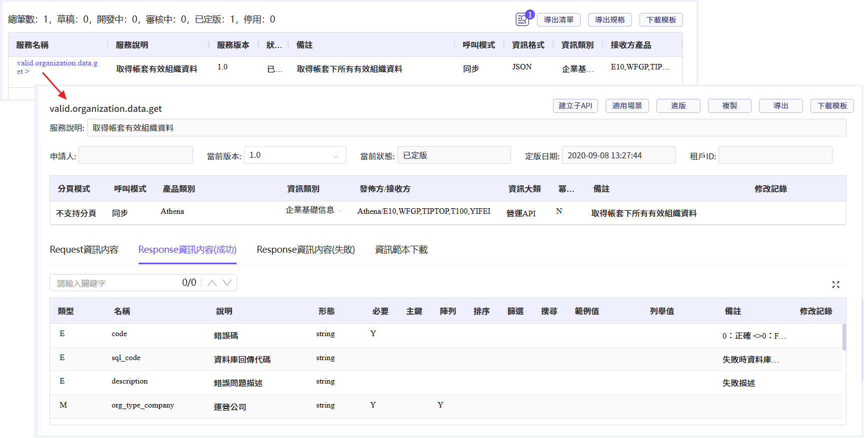

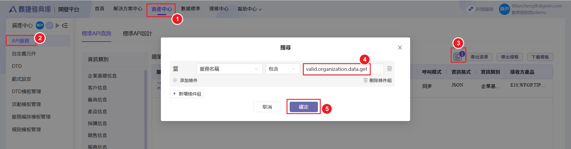

valid.organization.data.get的详细规格请至开发平台->资产中心->API服务,以服务名称查询,即可看到规格说明

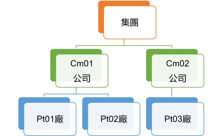

若地端产品的运营单元配置示意如下图:
则valid.organization.data.get服务的返回消息如下:
  "std_data": {
    "execution": {"code": "0","sql_code": "",   "description": "執行成功"},
    "parameter": {
      "org_type_company": [
          "company_no": "Cm01",
          "company_name": "Cm01公司",
          "org_type_site": [
              "site_no": "Pt01",
              "site_name": "Pt01"
              "site_no": "Pt02",
              "site_name": "Pt02"
          "company_no": "Cm02",
          "company_name": "Cm02公司",
          "org_type_site": [
              "site_no": "Pt03",
              "site_name": "Pt03"
