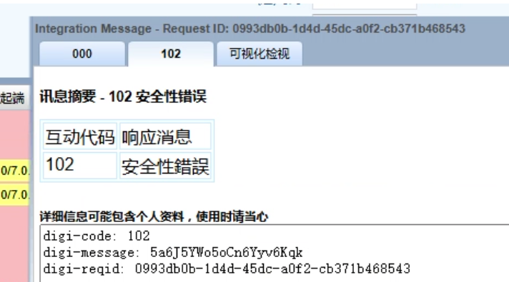

中台呼叫報錯:102 安全性錯誤 (有造中台规范产生加密KEY,为何还是报102的安全性错误?)
digi-type: sync
digi-service: {"prod":"E10","name":"XISSUE_RECEIPT.ImportDataReceiptOut","id":"Actec","ip":"192.168.2.8"}
digi-host: {"prod":"XThirdParty","ver":"1.0","ip":"192.168.2.21","id":"XWMS","timezone":"+8","timestamp":"20260407142240538","acct":"dcms"}
digi-data-exchange-protocol: 1.0
digi-key: 50918e2d236a2f6ce6119e0e89845872
    "std_data": {
        "parameter": {
            "datas": [

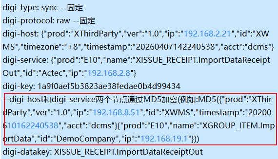

问题原因
中台加密验证KEY有误(顺序反了)
处理步骤
客户有产生中台加密的 key,不过组的方式有误
加密是先digi-host后digi-service
客户顺序反了,所以产生了不正确的KEY
参考说明如下
