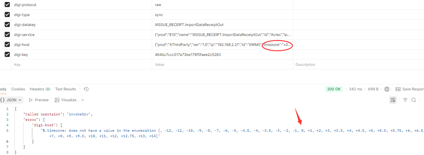

中台呼叫出現999錯誤,请求入参如下,哪里有错?
digi-protocol: raw
digi-type: sync
digi-datakey: XISSUE_RECEIPT.ImportDataReceiptOut
digi-service: {"prod":"E10","name":"XISSUE_RECEIPT.ImportDataReceiptOut","id":"Actec","ip":"192.168.2.8"}
digi-host: {"prod":"XThirdParty","ver":"1.0","ip":"192.168.2.21","id":"XWMS","timezone":"+0","timestamp":"20200526062240538","acct":"dcms"}
digi-key: 464bc7ccc017a73be179f5faee2c5283
姜文盛楼主Lv.7 发表于 前天 08:58 | 查看全部
问题原因:timezone 格式有誤
中台的timezone没有+0这样的格式,要调整成0,或调整产品维护,改成+8,才能正常呼叫
